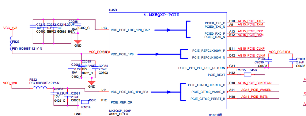

baiseyuzhou
您好,我也遇到了同样的问题,请问一下是怎么解决的,谢谢!
我的原理图:

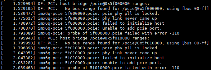

liuzhi
感谢帮助,问题已经解决,对比发现是外部给imx8的clk不稳定导致的。

健谭谭
imx-scfw-porting-kit-0.7/mx8qx_b0/scfw_export_mx8qx/platform/board/mx8qx_mek/board.c
/* Used whenever HSIO SS powered up. Valid return values are
BOARD_PARM_RTN_EXTERNAL or BOARD_PARM_RTN_INTERNAL */
case BOARD_PARM_PCIE_PLL :
- rtn = BOARD_PARM_RTN_EXTERNAL;
+ rtn = BOARD_PARM_RTN_INTERNAL;
重新生成scfw_tcm.bin。

liuhongbo1
你好,我根据你说的修改后PLL是锁了,但还是会初始化失败
能否贴一下你的dts部分呢
谢谢~

gnar_fang
   Can you show your schematic for more detail about pcie ?
   Then you can refer to it. https://community.nxp.com/message/1115151
6,269 Views
igorpadykov
Hi 健 谭
unfortunately so far there is no hardware guide document for that part (it is still preproduction),
Some preliminary pcie check points: check AC coupling at each transmitter (use a 0.22 μF cap on both the
PCIE_TXP and PCIE_TXN outputs). The receiver must be DC coupled.
Check voltages on VDD_PCIE0_1P0, VDD_PCIE1_1P0,
PCIE_REF_QR ball should be connected to ground through a 453 Ω, 1% resistor,
PCIE_REXT ball should be connected to the PCIE0_PHY_PLL_REF_RETURN
ball through an 845 Ω, 0.5% resistor.
