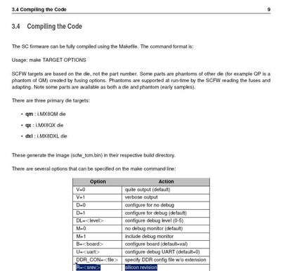

>How should I build imx8qxpc0 yocto build in kernel 4.14.98_2.3.0?
it is the same as for kernel 4.14.98_2.0.0, for rev.C0 one needs to build SCFW with "R="
silicon revision option, described in SCFW Porting Kit​
https://community.nxp.com/t5/i-MX-Processors-Knowledge-Base/MX8X-4-19-35-ga-BootLoader-V6-20200217-c...
