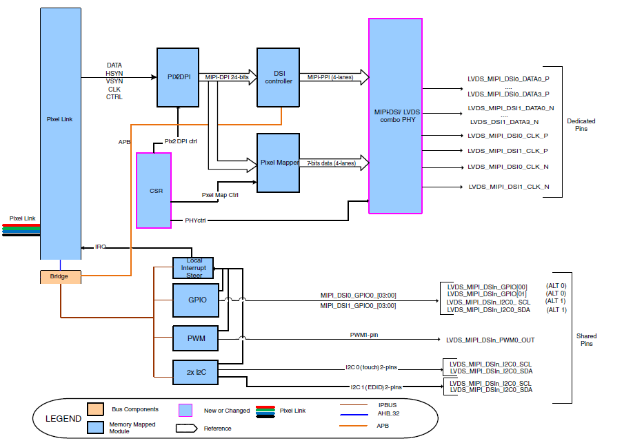

For the imx8qxp what does the number 8 on this line mean? I can't find it in the manual reference.

Hello Cesar,
The interrupt 8 in the code snippet there is for the lpi2c module. It goes into the local interrupt steer block of Figure 15-12 of the Reference manual.
Unfortunately, this info is currently missing from the RM as well as from internal architectural documents. The good news is that R&D is aware of the lack of documentation and is working on generating it. The 8QM RM is undergoing the update first; the QXP RM should follow. Sorry for the inconvenience.

Can you posted the figure please?
