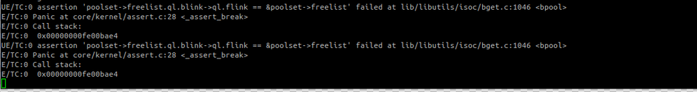

Hi,guys,
isSPIBuild=false DISTRO=fsl-imx-xwayland MACHINE=imx8qxpc0mek NUMBER_ID=$NUMBER_ID source ./yocto_env_setup.sh
bitbake core-image-emmc
build/tmp/deploy/image/imx8qxpc0mek/  only have" xx-sd.flash_linux_m4" and "xxx-sd.flash_spl".
i modify :
diff --git a/imx/meta-bsp/conf/machine/imx8qxpmek.conf b/imx/meta-bsp/conf/machine/imx8qxpmek.conf
old mode 100644
new mode 100755
index 75fa6ee..8187481
--- a/imx/meta-bsp/conf/machine/imx8qxpmek.conf
+++ b/imx/meta-bsp/conf/machine/imx8qxpmek.conf
@@ -55,7 +55,7 @@ IMAGE_BOOTLOADER = "imx-boot"
 IMX_BOOT_SEEK = "32"
 IMXBOOT_TARGETS_SD = \
-    "${@bb.utils.contains('COMBINED_FEATURES', 'optee', 'flash_linux_m4 flash_spl', \
+    "${@bb.utils.contains('COMBINED_FEATURES', 'optee', 'flash_linux_m4 flash_spl flash', \
                                                         'flash flash_regression_linux_m4', d)}"
 IMXBOOT_TARGETS_FSPI = \
     "${@bb.utils.contains('COMBINED_FEATURES', 'optee', 'flash_spl_flexspi', \
can build "xxx-sd.bin-flash" ,but  cannot work and size 1M:
TKS,
BRs,
Gravity

Did you try to use "xxx-sd.flash_spl"? "xxx-sd.bin-flash" is common used in I.MX8M series.
Zhiming

Hi ,Zhiming
use bin-flash-spl, Soc debug ouput:
Screenshot from 2020-12-21 10-19-15.pngwhy i cannot build xxx-sd.bin-flash? But the official image package includes sd.bin-Flashrefer to :L5.4.24-2.1.0_images_MX8QXPMEKtks
