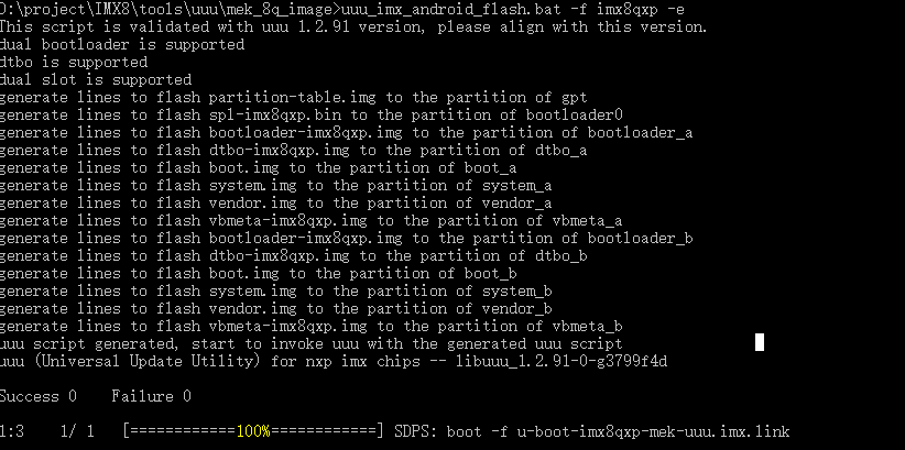

when burnning androidP 2.1.0 car image into 8qxp board, it says below error. please give some advice. thanks.

Hi jiu
what board used in the case, if this is custom board, image should be rebuilt
with new ddr settings found from ddr test. If this is MEK board, one can try other board
or try to run Linux Image from :
i.MX Software | NXP
igor

D:\project\IMX8\tools\uuu\mek_8q_image 的目录

D:\project\IMX8\tools\uuu\mek_8q_image>p

=>  mmc dev 1
MMC: no card present
=> mmc dev 0
switch to partitions #0, OK
mmc0(part 0) is current device
=> mmc info
