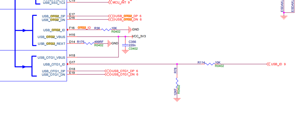

使用usb otg 1烧录和adb调试。烧录ok,adb 不通。
其中usbotg3作为host是好的,可以插鼠标使用。
麻烦大家帮忙分析一下,谢谢大家了!
软件配置
&usbotg1 {
vbus-supply = <&reg_usb_otg1_vbus>;
dr_mode = "otg";/*peripheral*//* host */
srp-disable;
hnp-disable;
adp-disable;
power-polarity-active-high;
disable-over-current;
status = "okay";
&usbotg3 {
dr_mode = "host";/*peripheral*//* host */
srp-disable;
hnp-disable;
adp-disable;
status = "okay";

xinchuan_2023
Hello Sanket,
attachment log.txt is the log,
there is no interrupt when I connect the usb_otg1 to the computer,and there is no error logs.
but the usb_otg3 is ok as host,
thanks.

xinchuan_2023
Hello Sanket ,
make changes as below. adb is ok.
- setprop vendor.usb.config "5b110000.usb3"
+ setprop vendor.usb.config "ci_hdrc.0"
thanks.
