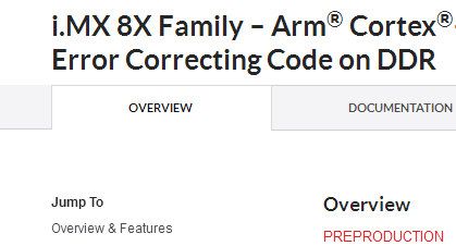

igorpadykov
this is preproduction part and software for it is under development
