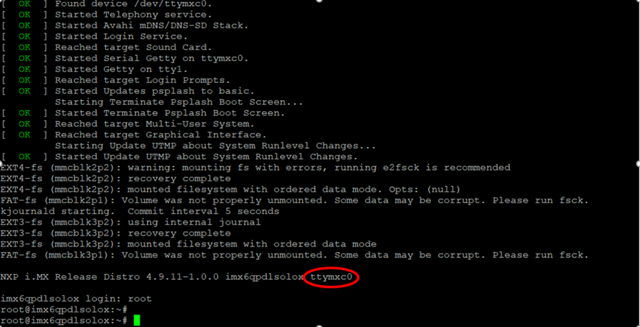

Device : imx8qxp
Board  : imx8qxp-mek
Linux version : 4.14.78-ga(officially released by NXP, stable)
                        4.9.88-beta
1. Password needed when log in terminal.
2. During the bootup, Var directory in NFS was locked.
Hope you guys give some helpful suggestions.

My boot setting:
setenv serverip 10.xxx.xxx.74
setenv ipaddr 10.xxx.xxx.100
setenv ethaddr 00:01:02:03:04:05
setenv fdt_file fsl-imx8qxp-mek.dtb
setenv ip_dyn no
setenv netargs setenv bootargs console=${console},${baudrate} ${smp} ip=dhcp root=/dev/nfs nfsroot=${serverip}:${nfsroot},v3,tcp
setenv nfsroot /home/cqc/rootfs_4_imx8qxp_4.14.78
saveenv

nxf45220
Hi Artur,
Thank you for your replay.
1. The problem you mentioned caused by the wrong format.
setenv rootfsinfo 'setenv bootargs ${bootargs} root=/dev/nfs ip=dhcp \  nfsroot=${serverip}:/home/cqc/rootfs_4_imx8qxp_4.14.78,v3,tcp'
setenv bootcmd_net 'run rootfsinfo; tftp ${image}; tftp ${fdt_addr} ${fdt_file}; booti ${loadaddr} - ${fdt_addr}'
2. Checked the uboot env difference between i.MX6 and i.MX8, they used different terminals type(see below two pics).
Fig 1. i.MX6 terminal type
Fig 2. i.MX8 terminal type
Checked /etc/securetty file of my server, ttyLP0 is not supported to log in, I think this may the root cause for the log in failure,  can you give some suggestions? Much thanks!
Best

nxf45220
Hi community,
The issue was confirmed as the settings of server(as mentioned before), ttyLP0 is not supported to log in as root, you can replace /etc/securetty file with my attachment, hope it'll helpful!
Best
5,457件の閲覧回数
nxf45220
Actually,
The log-in failure is caused by the authentication of file system, when I set the permission of file system to 777, the failure occurred, so do not change this when you setup the the NFS.
Best,
