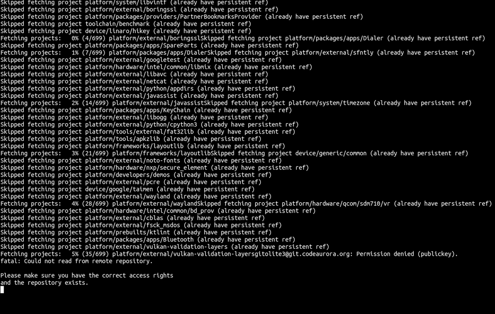

I got Android P9.0.0_2.3.2 from i.MX Software and Development Tools | NXP ->Android P9.0.0_2.3.1 Documentation,
when i sync code multiple times, some errors displayed, i think the reason is manifest.xml reference a private repo, anyone can help ?

Hello Zare Laky,
Does the problem still persist?
Have you configured git with an e-mal address and name? The repository should be public but it could be that it requires identification.
