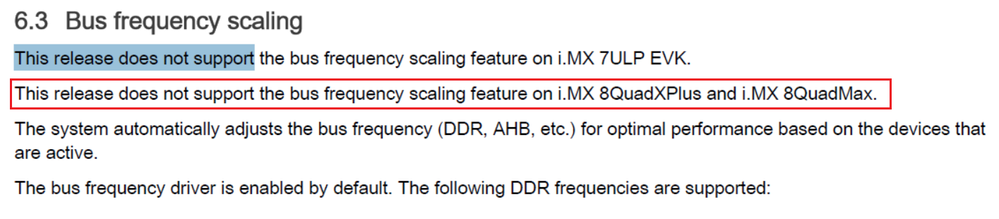

I have an imx8qmmek, image built with Yocto Sumo, kernel 4.14.98_2.0.0_ga.
I would need to modify the ddr bus frequency, but at the i.MX_Linux_User_Guide manual, paragraph 6.3, I see that "This release does not support the bus frequency scaling feature on i.MX8QuadXPLus and i.MX8QuadMax".
So, does there is a Release in which this feature is available in imx8qmmek too ?
If not, does there is a doc (or patch) for taking some hints?

Hi lorenzo_sarchi ,
  The latest version of linux BSP, L5.4.70_2.3.0 still doesn't support bus frequency scaling feature on i.MX8QM/i.MX8QX, no patch for it.
Hope the information is helpful to you.

Do you have an hint to give me for scaling the frequency?
I mean: files to look at, suggestions,...
This is really important for us.
