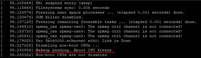

hello nxp,
now we develop on imx8qm board with linux 5.10, we met a suspend abort issue and after revert below patch, this issue gone, could you help?
https://source.codeaurora.org/external/imx/linux-imx/commit/drivers/mailbox/imx-mailbox.c?id=2385741...
yuchao

yuchao_du
hello nxp,
I think this suspend abort issue because this case, could you help for fix this issue base on this patch?
scu driver register mu channel
       -> imx_mu_startup
                 ->set IRQF_NO_SUSPEND for wakeup source
Linux suspend
      -> imx_mu_suspend_noirq
                  ->set priv->suspend = true
----->this time, scu mu irq enter
      -> imx_mu_isr
                  ->judge priv->suspend == true
                               ->pm_system_wakeup abort suspend, wakeup linux
2,087 Views
