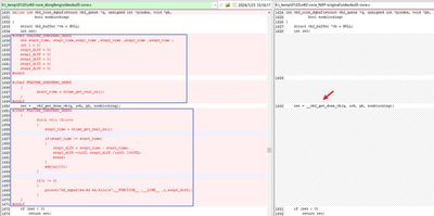

Our car IVI product is already saled for 2 years ,but a few customers have some complain:
In low posibility,the camera is very slow ,the frame rate is almost 1 or 2 frme per second.we debug and find the __vb2_get_done_vb() will cost 2~3s continuously each time when it happened.
below is the method to check the time used:
We find the __vb2_get_done_v() will cost 2010443 us,namely 2 seconds:
we are using IMX8QM linux kernel 4.14.98 baseline,the code and its log is attached ,can you help to give us some suggestion?
