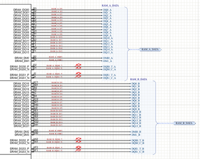

We try to bring up a custom iMXPlus board first with MScale DDR tool to calibrate the LPDDR4 memory. Our memory is 4GB and our problem is that the MScale tool is only able to detect half of it (2GB).
Our question is do you think it is a configuration or soldering problem?
Below I send the info about the hw and sw as well:
Memory side DDR connection of the schematic:
iMX8Plus side DDR connection of the schematic:

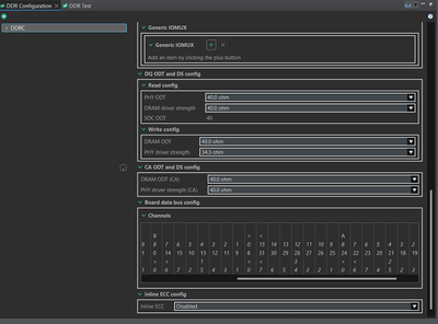

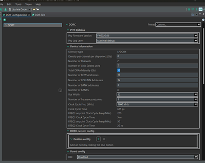

imx8 Config tool setting  that does not work for 4GB (then we export the .ds file to MScale tool that generated the timing for bootloader). For the working configuration (2GB) we set Density per channel  per chip select to 16Gb and only 1 used chip select.

We use the config tool because it is easy to configure the LPDDR4 there (respect to the excel RPA file) that generates us the .ds file that we can feed in to the Mscale DDR tool. With Mscale tool we calibrate the memory that generates us the timing.c file that we put into the bootloader. That is all we need, but correct me if I am wrong.
For the hardware I attach the two pages of the schematics.
Please tell us why Mscale only recognizes 2GB of RAM with one chip select configuration and does not recognize the whole 4GB when we configure with 2 chip selects. Do you think is it soldering or not (at least one pin is not attached well
on a channel)?
Andras

Hi Rita,
When we tried the stress test or other tests with the config tools it also failed the same way when we used this configuration (4GB). With 2GB (1 chip select) all tests are fine with both the config and the mscale tool as well. What do you think?
Andras

Dear @Andras_Magyar ,
Could you share your clear schematic to us, for the above supply we can not see clearly.

Andras_Magyar
Hi Rita,
I also uploaded the schematics above.
Do you see it?
