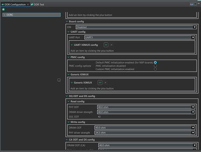

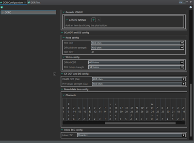

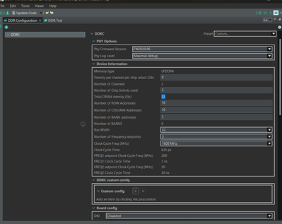

imx8 Config tool setting  that does not work for 4GB (then we export the .ds file to MScale tool that generated the timing for bootloader). For the working configuration (2GB) we set Density per channel  per chip select to 16Gb and only 1 used chip select.
Finally the MScale log when we tried to do the callibration:

We use the config tool because it is easy to configure the LPDDR4 there (respect to the excel RPA file) that generates us the .ds file that we can feed in to the Mscale DDR tool. With Mscale tool we calibrate the memory that generates us the timing.c file that we put into the bootloader. That is all we need, but correct me if I am wrong.

Here I do not know if is you are using these two tool together cause this problem, here recommend you to use the config tool to configurate and then also use it to do the stress test.
Or you use the i.MX 8M Family DDR Tool Release - NXP Community this script to configurate the ddr parameters and then use this tool to do the test.

When we tried the stress test or other tests with the config tools it also failed the same way when we used this configuration (4GB). With 2GB (1 chip select) all tests are fine with both the config and the mscale tool as well. What do you think?
