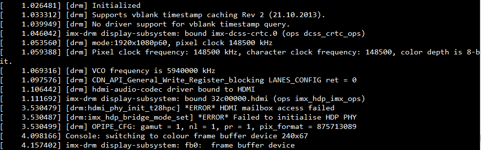

lingguan
2,983 Views
harry_cheng
I read your question, it looks different with mine, because I don't have display even in u-boot while you have it.
Boris' suggestion to upgrade the kernel might be a good solution for you.
Perhaps you can also consider trying a different monitor. As Diego said, not all monitors are supported.
