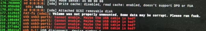

Hi :
    I got a problem with IMX8MQ EVK, yocto 4.14.98 and win10IOT.
    I connected a uDisk throught the TYPC port and the USB HOST port with TYPC OTG and an extend cable, and the extend cable  has only usb2.0 capablity , and found that some USB3.2 uDisk could not be recognised, and some not stable.
   log of not stable:
log of not recognise:
But the uDisks and cables are not problem  in imx8mp and imx8mm evk.
could anyone take a look at this ?
253 Views
Rita_Wang
For the i.MX8MQ support Two USB 3.0/2.0 OTG controllers with integrated PHY interface. How about using the newest BSP?
