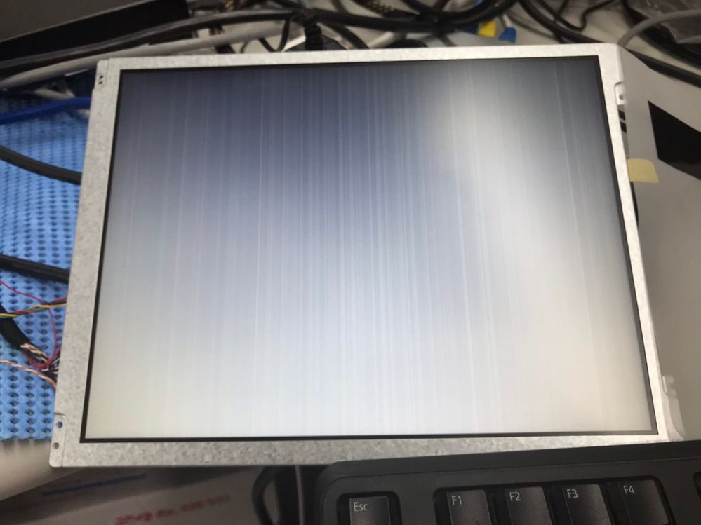

Hi, Thanks for your reply. Now i can see backlight  turn on , but no image.
I need to check what some items?
Below is my DTS configuration for LVDS:

igorpadykov
for image issue suggest to create new thread.
