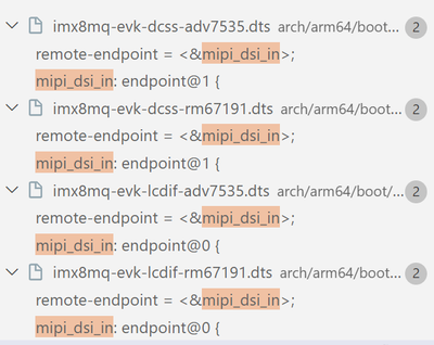

I have canceled adv7535 settings(Makefile) and add sn65dsi83 in imx8mq-evk.dts, but it looks some duplicate definitions.
Does any one have any suggestions about sn65dsi83 with 6.6.23 porting?Thanks.
The Error message as below:
ERROR (duplicate_label): /soc@0/bus@30800000/dsi@30a00000/ports/port@0/endpoint: Duplicate label 'mipi_dsi_in' on /soc@0/bus@30800000/dsi@30a00000/ports/port@0/endpoint and /soc@0/bus@30800000/dsi@30a00000/ports/port@0/endpoint@1
ERROR (duplicate_label): /soc@0/bus@32c00000/display-controller@32e00000/port/endpoint: Duplicate label 'dcss_out' on /soc@0/bus@32c00000/display-controller@32e00000/port/endpoint and /soc@0/bus@32c00000/display-controller@32e00000/port@0/endpoint

Hi @Ichi_
Please upload the dts file here.

Ichi_
Hi Zhiming_Liu
The imx8-evk.dts and Makefile.7z has been uploaded.
914 Views
Zhiming_Liu
You don't have to comment other dts which contains mipi_dsi_in and dcss_out, you can use sn65dsi83_in and dcss_out_sn65dsi83.
Best Regards
Zhiming
879 Views
Ichi_
The duplicate_label error has been solved after changing to sn65dsi83_in and dcss_out sn65dsi83, and can see additional additions in ti-sn65dsi83.c sn65dsi83_probe log when boot.
