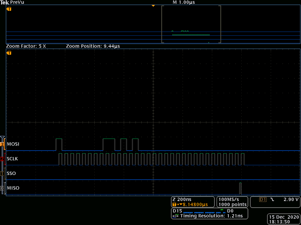

I am attempting to interface infineon optiga slb9670 tpm2.0 to the imx8mq single board computer by compulab.
I am using kernel version with the tag : rel_imx_5.4.24_2.1.0
SPI channel: ecspi2
The optiga TPM is running successfuly on raspberrypi with the waveform capture below.

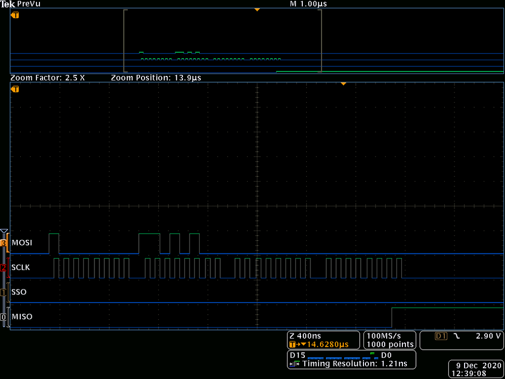

However, with the imx8mq board, i got the results as shown after enabling MOSI idle low (modifying spi-imx.c)
The TPM module is unable to respond without having some byte to byte nanosecond delay. I've tried the following:
1) adjusting burst mode into 8 bit (ended up having multiple 8 byte packet with 20uS apart, doesn't work)
2) enabling  periodreg by writing 0x08 (no changes)
3) utilize PIO mode instead of DMA (no changes)
Anybody can advise on this?

Hi igor,
I've lowered down the operating frequency from 32mhz to 1mhz , and the response is still not what is expected. From the working raspberry pi example, I need to introduce byte to byte delay at the MOSI side, the byte shifted out from the imx8mq is too fast for the optiga tpm module.
