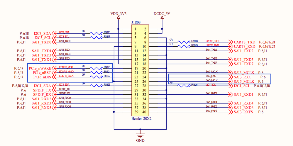

I want to change the default routing for the next three pins by configuring the device tree.
Because we now want to lead out 40 pins on the new board for users' independent development, including SPI,GPIO,UART,I2C device interface.
So,what I shound do through change dts.
Attached is the hardware schematic diagram of customer development board

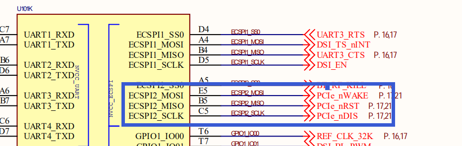

1. Remove these pins related to ECSPI2
    pinctrl_pcie1: pcie1grp {
        fsl,pins = <
            MX8MQ_IOMUXC_I2C4_SDA_PCIE2_CLKREQ_B        0x76 /* open drain, pull up */
            MX8MQ_IOMUXC_ECSPI2_SCLK_GPIO5_IO10        0x16
            MX8MQ_IOMUXC_ECSPI2_MISO_GPIO5_IO12        0x16
By default, on i.mx8mq-evk, above 2 pins are multiplexed as GPIO, both for PCIe port, so you should remove them, and then assign other 2 GPIOs for PCIe port if you also want to use PCIe.

你要连接2个device,当你的device tree里需要给spi节点2个chipselect了。你现在只有一个,那么就会只有spidev1.0。
(1)你的引脚定义的24/26脚,没有连接到ECSPI2_SS0上,那么也就是说上面的复用是无效的。你应该一个spidev都看不到的。
(2)你的CE0/CE1用的是SAI3_RXC和SAI5_MCLK,理论上复用为GPIO做应该可以做CS用。你可以试试行不行。

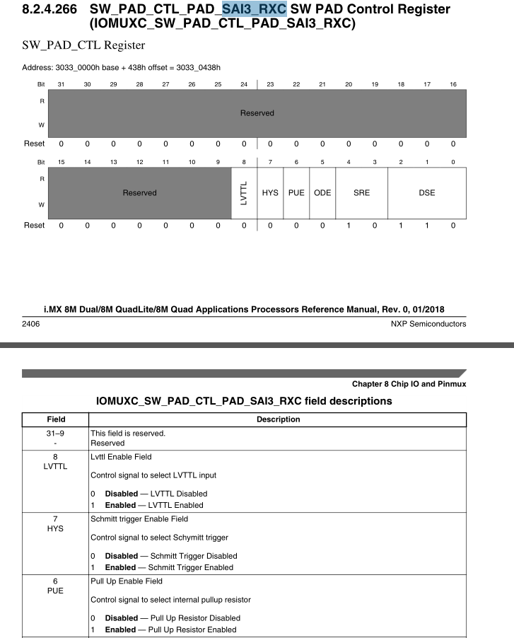

41,304 次查看
gaobo
我根据您配置ECSPI2_SCLK、ECSPI2_MOSI、 ECSPI2_MISO三个管脚的控制寄存器的值,来配置了SAI3_RXC和SAI5_MCLK两个控制寄存器的值为0x82但是结果差强人意,还是没有出现相应的spidev,但是新添加的ecspi2节点应该是注册上了。
为了节约您的时间。我把SAI3_RXC和SAI5_MCLK两个管脚控制寄存器的datasheet放在下面,麻烦您帮忙解决一下。
41,304 次查看
weidong_sun
DSE = 100
SRE = 01
ODE = 0
PUE = 0
HYS = 1
LVTTL = 0
凑起来就应该是:          1000 1100 -- >0x8C
你试试行不行。
Weidong

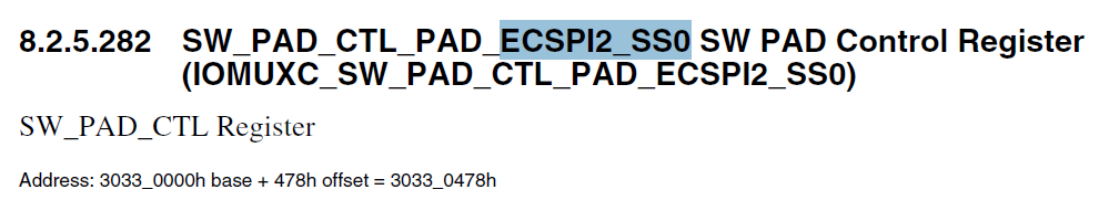

0x82 is value of it's PAD control register, for example: ECSPI2_SCLK's pad register is :IOMUXC_SW_PAD_CTL_PAD_ECSPI2_SCLK , page 1744, reference manual.
the register is used to tune driver strengh of the PAD.   you can change the configuration for you application.
For other pads, like ECSPI2_MOSI/ECSPI2_MISO/ECSPI2_SS0, they also have related pad control register.
they are all described in reference manual.
Have a nice day!

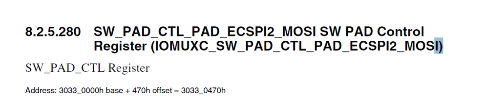

gaobo
Hi Wigros Sun:
I see what you mean.I want to know how to select the pad register value of other pins in dts.The pins correspond to each other on the two pictures.
We look forward to you reply.
Have a nice day!
41,304 次查看
weidong_sun
 MX8MQ_IOMUXC_ECSPI2_SCLK_ECSPI2_SCLK         0x82
it means that 0x82 will be written to IOMUXC_SW_PAD_CTL_PAD_ECSPI2_SCLK. Not Read.
Read and understand each filed of the register. then configure (write value to the register) them.
Weidong
