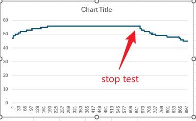

944件の閲覧回数
Zhiming_Liu
I did test on EVK while running the GPU rendering program. From the test results, it is not an internal problem with the i.mx8mq. The heatsink reaches some kind of equilibrium, so the temperature is constant, and when I stop the test program, the temperature is updated immediately. The attachment is test log.
