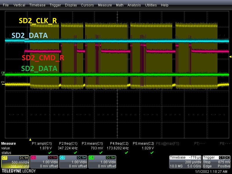

Hello, we're developing custom SOM based on imx8mq module. We verified boot from emmc which works fine by flashing image using uuu utility. We also have SD card on uSDHC2 but when SD card is flashed manually using dd image won't start booting. We checked with scope and following was measured:
Clock seems to be also strange. Do you have any ideas what we can check? Is there possibility to change pinmux in some early stage when bootrom start fetching image (just hypothetical question)? Thanks.

Hi Igor,
Thanks for reply. Yes board pass DDR init as same image can boot from emmc and we generate ddr training from official nxp memory tool.

so it's for pads configs (pull up/down etc) but can I change pinmux of pin like attach it to alt config or so? Thanks.
sorry pinmux of pin can not be changed.

Hi Marek
had board passed ddr test and image was updated with new DDR initialization code according to MSCALE_DDR_Tool_User_Guide
https://community.nxp.com/t5/i-MX-Processors-Knowledge-Base/i-MX-8M-Family-DDR-Tool-Release/ta-p/110...
> Is there possibility to change pinmux in some early stage when bootrom start fetching image..
yes. One can look at fuse 0X490[31:24]  USDHC pad setting override
"Override pad settings default if 0X490[17] is set" described in Table 6-14. USDHC boot eFUSE descriptions i.MX 8M Dual/8M QuadLite/8M Quad Applications Processors Reference Manual
