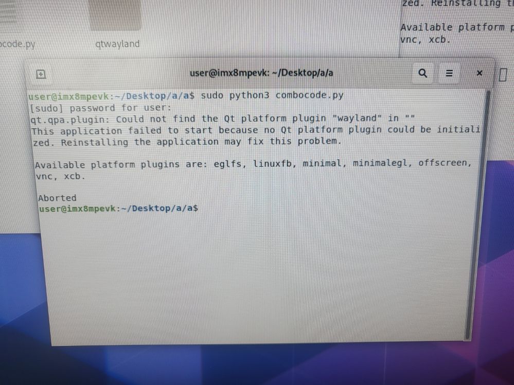

Ubuntu rootfs

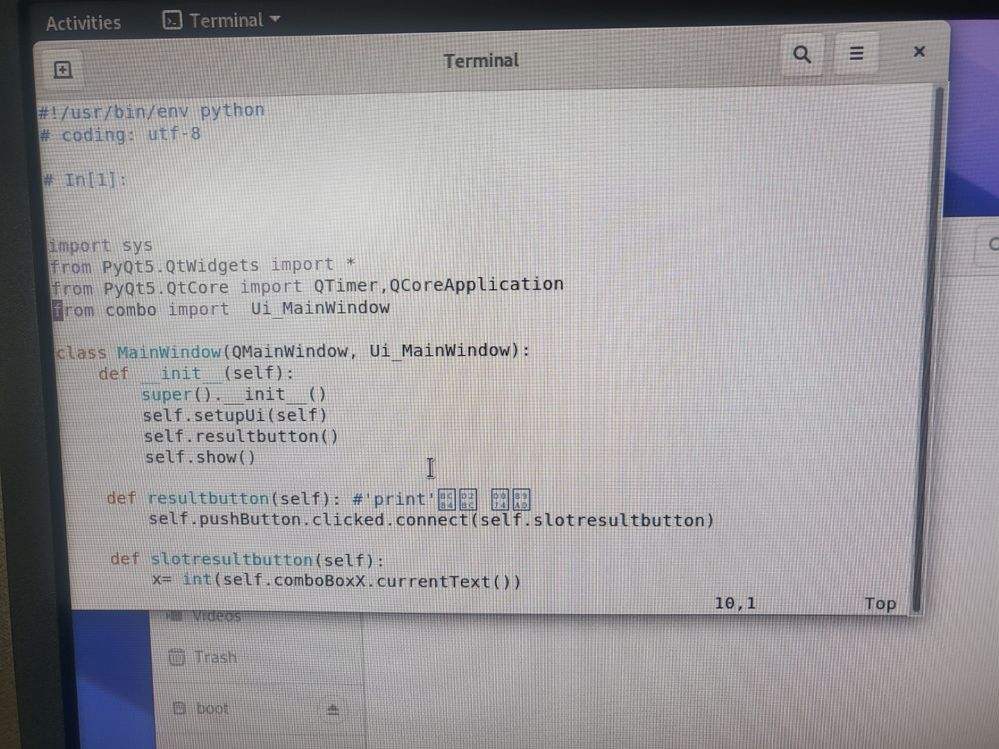

I installed "pyqt5" with "sudo apt-get install python3-pyqt5".

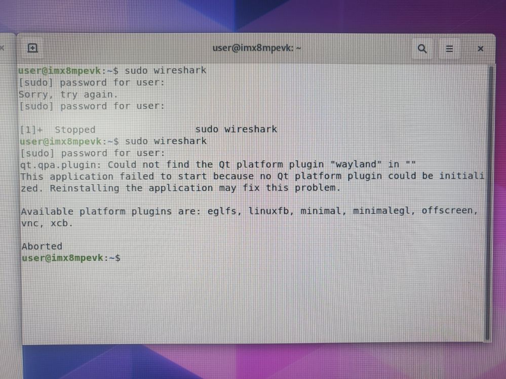

I also installed "sudo apt-get install wireshark".
An error occurred while running the "wireshark" or simple "python3" program.
An error occurred in "qt.qpa.plugin: cannot find the Qt platform plugin "wayland"." Please help me.

Hi Park
one can look at below link which has info for porting your Qt applications
https://wayland.freedesktop.org/toolkits.html
igor
