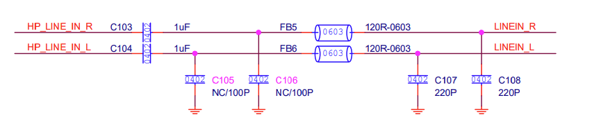

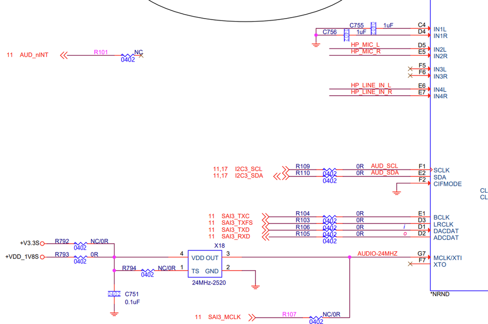

IMX8MP+WM8962 recording line in problem.
Audio playback works fine, but we connected line out and line in, no sound was recorded.
Diagram:
Added device to devicetree:

The above are my settings. I use arecord and aplay to record.
The audio files that can be recorded have no sound at all
Do you have any suggestions on what needs to be modified or set up?
