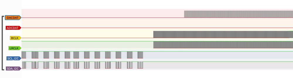

Now I have signals on the BCLK, LRCLK and DAC, ADC lines, but I have no sound at the output, on the speakers.
5,926件の閲覧回数

I checked the signal lines in both cases.
Everything looks correct, but the codec does not output any signals to the speakers.
It looks like a configuration problem but I have no idea what could be wrong.
5,861件の閲覧回数
JorgeCas
I am a little confused, your image shows data on ADCDAT line. This is an output from the codec. When you are playing audio from the MPU you should see data on DACDAT line.
I think that the image is not showing all the data transfer. Could you confirm it?
Best regards.
Jorge.
5,815件の閲覧回数
robertZ
yes you are right adcdat is the output of the codec. I got the signals wrong and it should be the other way around.
I checked again to make sure and it's just a naming error.
I'm sending the corrected image of the signals again.
Yes, the image does not show the entire data transfer.
