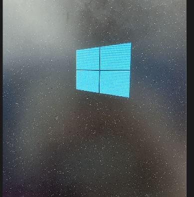

I'm trying to upgrade the version to 1.5.0, but it fail to bootup, it shows up the first window picture as bellow and stop.
After research , when I use uefi.fit from 1.4.0, it can bootup success (only change uefi.fit is enough, anther source are from 1.5.0).
And there is WARNING: " WARNING: Test Key is used"
My board's DDR is 3GB only.
Any suggestion ?
Thanks.

Press ESCAPE for boot options ** WARNING: Test Key is used. **

jiangyaqiang
Contributor V
Hi:
upgrade to version1.5.0 seems no display pattern issue.
And the bootup issue can be fixed by:
mu_platform_nxp/NXP/MX8M_PLUS_EVK/MX8M_PLUS_EVK.dsc
change : giMX8TokenSpaceGuid.PcdBank1MemorySize|0x00000000C0000000 to giMX8TokenSpaceGuid.PcdBank1MemorySize|0x000000000000000
Thanks.
