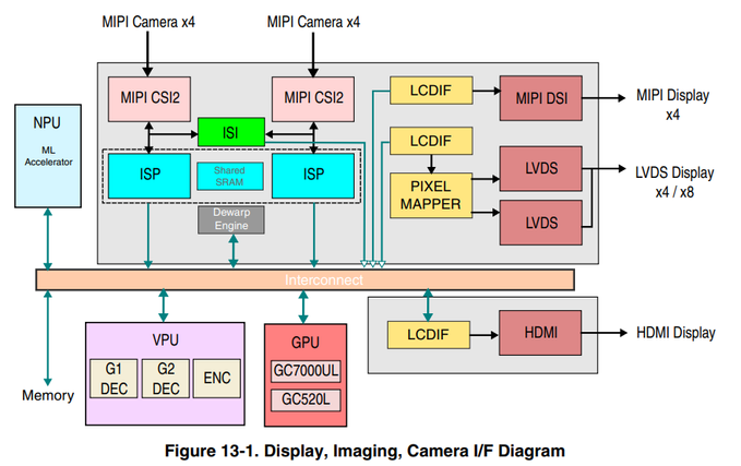

We need to use HDMI out and two LVDS out in parallel.
HDMI via the normal hdmi dts instance and LVDS via two adv7393 connected to ldb lvds channel0 and channel1.
With ldb lvds untouched, HDMI is working so far. Weston can start and use HDMI-A-1.
Then, I enable one of the adv7393 by adding the endpoints in
lvds-channel 0, port 1  and the hdmi part stops working and weston tells me, that there are no drm devices found.
How are the ldb and hdmi connected to each other, that the influence each other?
Any help is appreciated!
Kind regards
Thilo

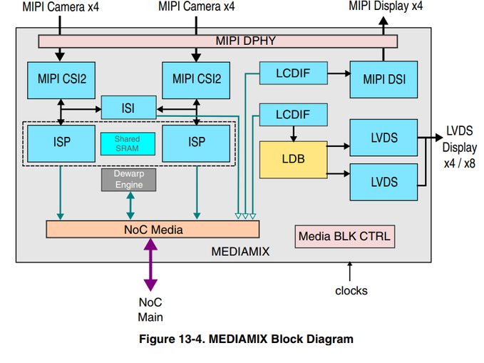

Finally regarding your initial question one could refer to the reference manual Figure 13-1. Display, Imaging, Camera I/F Diagram & Figure 13-4. MEDIAMIX Block Diagram
Best regards/Saludos,
Aldo.
98 Views
cthilo
Hi Aldo
so HDMI should not be related to the lvds out channels, when I interpret that overview correctly.
Anyway, I'll try to disable hdmi related stuff and test if the lvds setup only is working.
