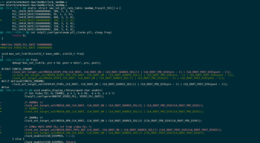

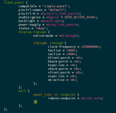

but my lcd screen is 25MHz and 800 X 480 resolution,so i need to change the clock
this is my change:
the change in uboot dts is as same as change in kernel.
Is there anything else that needs to be changed?

lcd backlight is on,buf no logo display
my picture format is right, and bmp cmdline parse success,buf not display
  • u-boot=> bmp info $splashimage
    Image size : 800 x 480
    Bits per pixel: 24
    Compression : 0
    u-boot=> bmp display $splashimage
    u-boot=>

在defconfig里加上CONFIG_SIMPLE_PANEL=y。
然后最重要的是修改其中的代码,添加获取timing逻辑,你可以参考以下修改(enable部分可以不注释,看你需求),或者你自己添加解析设备树获取timing的代码:

时钟没啥问题,数值都是正确的。
你要不把你跟我说的clock_8mp.c里面的修改复原一下?
