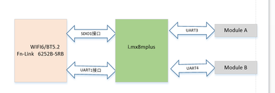

hello,
    Our device peripherals are shown in the figure below. After the device is powered on, it automatically connects to Wi-Fi and establishes communication with modules A/B. However, after running for a period of time , the qt application program becomes unable to receive data from modules A/B via UART3/4, although it can still send data to them. The Wi-Fi connection remains normal. If the Qt application is killed and reloaded when this issue occurs, communication can be restored.The kernel version is 5.10.9. What might be the reason for this, and how can we troubleshoot and resolve the issue? Thank you.

hellio,
      The attached device tree is for the currently problematic device, confirmed to be LF5.10.9

Hello @dreamxjtu
Thank you for sharing your files.
I could not find any device tree inconsistency, everything looks good.
Are you able to capture the UART signal with an scope or logic analyzer when this issue happens?
Also, please try to read the pinmux register with memtool when this issue is present.
Salas.
1,015 次查看
dreamxjtu
hello @Manuel_Salas
we have capture the UART3/4 TX/RX use a scope and logic analyzer when the issue happens.We found that the signals and data parsing are correct, with no abnormalities detected.
which pinmux register can we try to read?UART3/4 TX and RX?or other IO?
root@myd-jx8mp:/work/nfs/unit_tests# ./memtool -32 0x30330440 1
E
Reading 0x1 count starting at address 0x30330440
0x30330440: 00000140
root@myd-jx8mp:/work/nfs/unit_tests# ./memtool -32 0x30330444 1
E
Reading 0x1 count starting at address 0x30330444
0x30330444: 00000140
root@myd-jx8mp:/work/nfs/unit_tests# ./memtool -32 0x30330498 1
E
Reading 0x1 count starting at address 0x30330498
0x30330498: 00000140
root@myd-jx8mp:/work/nfs/unit_tests# ./memtool -32 0x3033049C 1
E
Reading 0x1 count starting at address 0x3033049C
0x3033049C: 00000140
root@myd-jx8mp:/work/nfs/unit_tests# cat /proc/tty/driver/IMX-uart
serinfo:1.0 driver revision:
0: uart:IMX mmio:0x30860000 irq:32 tx:49174 rx:4241 DSR|CD
1: uart:IMX mmio:0x30890000 irq:34 tx:227698 rx:78 RTS|DTR|DSR|CD
2: uart:IMX mmio:0x30880000 irq:33 tx:579 rx:417229256 brk:12 oe:287947352 RTS|DTR|DSR|CD
3: uart:IMX mmio:0x30A60000 irq:40 tx:279 rx:90046331 oe:62148529 RTS|DTR|DSR|CD
