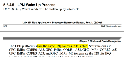

Why is it not possible to wakeup when in the GPC stopmode? Instead we need to send a any rpmsg to leave the GPC stop mode function to enter __DSB,
-->The interruprt could be masked in GPC_IMRx_M7 as the RM said that any M7 interrupt can wake up M7 from LPM. The process of sending rpmsg will use Message Unit to generate interrupt to M7, i think this is reasonable why you need to send rpmsg. So the MU interrupt should have been unmasked in GPC_IMRx_M7.You can trigger interrupt0 on Linux side in Message Unit hardware to wake up M7.

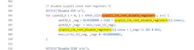

Zhiming_Liu
Is there any example of the bare minimum setup of clocks and plls to run m7 or m4 on? Any tricks to know that we have stopped all plls to enter dsm with fastmap in case that is the only one we can use? in AN13400 5.5.5 Disable System PLLs there is an example code but we cannot understand how it is supposed to work.
-->The example code is in ATF:https://github.com/nxp-imx/imx-atf/blob/lf_v2.6/plat/imx/imx8m/imx8mp/imx8mp_lpa_psci.c
Right now, we have in our clock_config.c only the 'CLOCK_M7RootmuxSysPll1' and comment out the reset, it seems to get the unit a bit lower in current consumption but still it does not set the PMIC_STBY_REQ to high.
For PMIC_STBY_REQ:
  On i.MX8MP, the power management code are in ATF(Arm-Trusted-Firmware). PMIC_STBY_REQ signal will be assert when system enters DSM mode in ATF code. Please check GPC chapter in RM for DSM description.
  In general, when both A core and M core are in STOP mode (Or A core in STOP, M core is not running) and all PLLs are disabled and bypassed, system can enter DSM mode.
  When all conditions meet (including GPC_SLPCR[VSTBY] is set), system will enter DSM after execute wfi command.
  ATF Code location:
plat/imx/imx8m/imx8mp/imx8mp_psci.c
plat/imx/imx8m/gpc_common.c
plat/imx/imx8m/imx8m_psci_common.c
