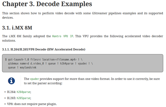

rradman_zenitel
Hi Vladan, thank you for responding!
Could you please elaborate why is this pipeline not working with vpudec?
It is recommended in the documentation, I'll post a screenshot bellow.
Thank you,
Robert
19,226 次查看
VladanJovanovic
Hi @rradman_zenitel
I'm not sure that vpudec doesn't work. I can start following pipeline through gst-launch without issues when I replace v4l2h264dec/enc with vpudec/enc:
root@imx8mpevk:~# gst-launch-1.0 filesrc location=btox_1080p_11_mbps.mp4 ! qtdemux ! h264parse ! v4l2h264dec ! tee name=t ! queue ! videorate ! imxvideoconvert_g2d ! v4l2h264enc ! h264parse ! rtph264pay ! rtpbin ! udpsink t. ! queue ! videorate ! imxvideoconvert_g2d ! v4l2h264enc ! appsink
So issue might be coming from your app as well. There's no reason tee should cause problems as it's fully SW plugin.
I also don't understand your pipeline - why do you first decode h.264 stream just to re-encode it (and in separate branches)? This doesn't seem very efficient way of operating.
br,
Vladan
