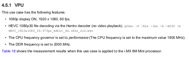

Hello Community,
I try to reproduce the power consumption test for VPU.
To get the same results, i need the same files for test.
Are the files used in the testcases of consumption test available?
The specific file I search for is: HEVC_1920x1080_29.97fps_AACLC_44.1Khz_2ch.mkv
Thanks in advance.
Simon

Ginzinger_sst
I know this AN, but there is no information about the used video file.

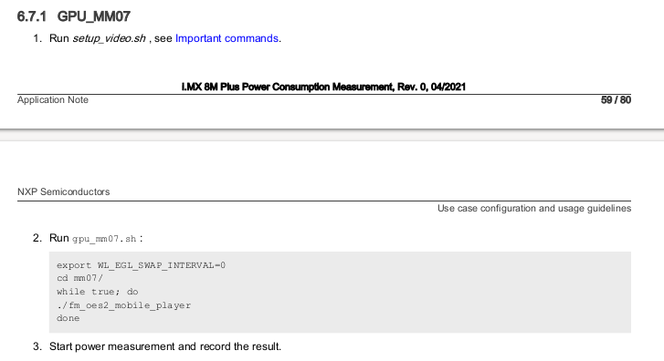

Ginzinger_sst
The AN does not work for me!
With this AN there come up some questions:
Where can i get the video file (HEVC_1920x1080_29.97fps_AACLC_44.1Khz_2ch.mkv)?video.png
Both are neither included in the image nor are there sources.
