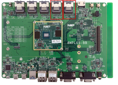

May I ask if the LVDS0 and LVDS1 interfaces of imx8mp can work on two screens simultaneously?
Do you have any examples?
618 Views
Chavira
HI @f1engmin11!
Thank you for contacting NXP Support!
imx8mp only can support one display with dual channel
608 Views
f1engmin11
thank you!
can it support 2 x LVDS Single Channel?we need to connect two display panel.
