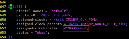

    imx8mp-evk + PDM mic(SPG08P4HM4H-1 * 2ea)
    1. When I check other case of PDM mic on NXP community & NXP's mic board, PDM_CLK 1MHz is ok. But 'SPG08P4HM4H' needs minimum 1.2MHz.
    So, I want to change PDM_CLK, But I can't understand the algorithm of assigned-clock-rates = <196608000>
    Could you explain the calculate algorithm using example real-use-case?
        196608000 means?
        MICFIL_CLK_ROOT = ? (code location)
        PDM_CLK = ? (code location)
    2. When I use memtool for reading PDM register, I does not work. (bus error? sorry, I have no captures now)
        command : memtool -32 0x30ca0000 1
        How I read the PDM register in this case?

The assigned-clocks -rate property on the mifcil node set the initial rate of the corresponding clk under the assigned-clocks. This is the IMX8MM_CLK_PDM is set to 196608000Hz at boot up.
&micfil {
      pinctrl-names = "default";
      pinctrl-0 = <&pinctrl_pdm>;
      assigned-clocks = <&clk IMX8MM_CLK_PDM>;
      assigned-clock-parents = <&clk IMX8MM_AUDIO_PLL1_OUT>;
      assigned-clock-rates = <196608000>;
      status = "okay";
If you dump the clk_summary just after booting linux

As you can see the pdm_root_clk (IMX8MM_CLK_PDM) is set at 196608000Hz
