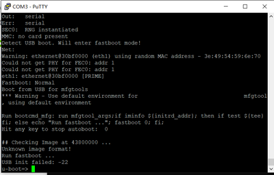

1.serial print above information

jimmyhua
1.imx8mp board switch to usb boot(1000).type-c connect to pc,open uart .otg connect to pc.
2.uuu -b emmc imx-boot-imx8mp-lpddr4-evk-sd.bin-flash_evk
step2 can not arrive.
serial print
what wrong?

mosfet1
1. It is very clear for the log, this board has different hardware to NXP i.MX8MP EVK. At least the usb has no typeC design. Should change the u-boot device tree to satisfy the hardware.
tcpc_init: Can't find device id=0x50
setup_typec: tcpc port2 init failed, err=-19
tcpc_init: Can't find device id=0x50 setup_typec: tcpc port1 init failed, err=-19
USB init failed: -22
2. If the ddr type(DDR4/LPDDR4) is wrong, could not run till u-boot console.
