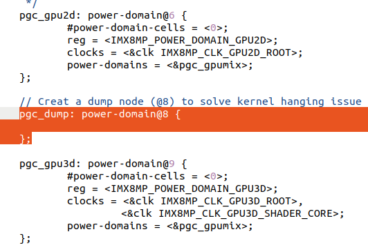

6,396 Views
Bassam
If someone still interested, I had the same issue where the boot stopped after "running /sbin/init"
I also had this error in the logs:
"imx-pgc imx-pgc-domain.8: failed to command PGC"
I use imx8mp, with kernel version 6.1.xx
And I was able to solve it when I added a dummy node for the pgc power domains in imx8mp.dtsi like in the attached photo
