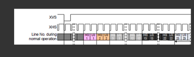

Sensor IMX662 : This sensor support clear HDR mode, in which two frames(high gain and low gain) will be interleaved without any compression as shown below.
I have updated all the necessary register to support clear HDR in sensor side, I have enabled virtual channel mode in clearHDR so that vc-0 will be containing high gain frame, and vc-1 will be containing low gain frame.

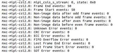

1. There is no error reported in mxc-mipi-csi2.0 below is the screenshot of status registers.

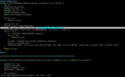

3. I have enabled debug prints in isp-imx source, During HDR stream the below mentioned poll is always getting timeout. There is no POLLIN is happening.
(units/fpgs/fpga/source/altera_fpga.c)

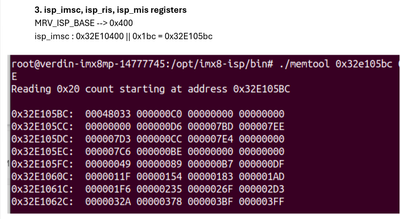

 4. below are the dumped registers for isp_imsc, isp_ris, isp_mis, isp_icr, isp_isr from vvcam/isp/mrv_all_regs.h

[ 3817.578091] mxc-mipi-csi2.0: Frame End: 50
[ 3817.578097] mxc-mipi-csi2.0: status: 00300000
[ 3817.603187] imx662 2-0042: entering th func:mcu_get_cmd_status
[ 3817.628757] imx662 2-0042: mcu_cam_stream_off 2807 MCU Stream Off Success !!
[ 3817.646275] enter isp_s_demosaic
[ 3817.649617] enter isp_disable_lsc
[ 3817.653206] enter isp_s_dpcc
[ 3817.656490] mxc-mipi-csi2.0: mipi_csis_s_stream: 0, state: 0x0
[ 3817.656541] mxc-mipi-csi2.0: Frame End events: 50
[ 3817.661259] mxc-mipi-csi2.0: Frame Start events: 50
[ 3817.666142] mxc-mipi-csi2.0: Non-image data after odd frame events: 0
[ 3817.672584] mxc-mipi-csi2.0: Non-image data before odd frame events: 0
[ 3817.679113] mxc-mipi-csi2.0: Non-image data after even frame events: 0
[ 3817.685642] mxc-mipi-csi2.0: Non-image data before even frame events: 0
[ 3817.692257] mxc-mipi-csi2.0: Unknown Error events: 0
[ 3817.697223] mxc-mipi-csi2.0: CRC Error events: 0
[ 3817.701841] mxc-mipi-csi2.0: ECC Error events: 0
[ 3817.706460] mxc-mipi-csi2.0: FIFO Overflow Error events: 0
[ 3817.711946] mxc-mipi-csi2.0: Lost Frame End Error events: 0
[ 3817.717520] mxc-mipi-csi2.0: Lost Frame Start Error events: 0
[ 3817.723267] mxc-mipi-csi2.0: SOT Error events: 0
[ 3817.728309] enter isp_s_vsm
[ 3817.731318] enter isp_s_afm
[ 3817.734172] enter isp_disable_awb
[ 3817.737510] enter isp_s_exp
[ 3817.740398] enter isp_s_hist
[ 3817.743881] enter isp_s_dpcc
