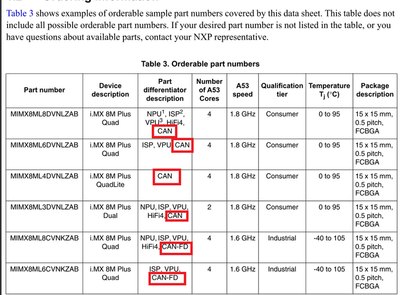

imx8mp cannot find device "can0" with Android13
1,238 Views
FoxYang
On IMX8MP EVK board with android-13.0.0_2.0.0_image_8mpevk.
# ifconfig -a
I cannot see can0,can1 device.
How to add it?
Thanks.
1,212 Views
Bio_TICFSL
The RM is a general description of the controller, but the enabled features depend on which part-number you pick, details can be found in the datasheet(captured below)
1,191 Views
FoxYang
On the same 8MP EVK board,use yocto(Linux 6.1.1_1.0.1 BSP) ,I can see device can0 can1.
But use Android (Android 13.0.0_2.0.0 (L6.1.22_2.0.0 BSP),I cannot see any CAN devices.
