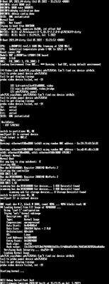

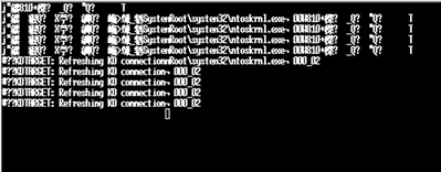

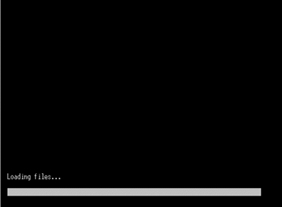

we want to build Win 10 IoT Enterprise Arm64 for imx8mp
There are the following questions in Our custom board
1. DDR 2G (imx8mp EVK 6G)
2. No SD card detect pin
So,I must modify the u-boot and other i'm not sure files
Currently, u-boot has been modified and also run to efi shell,But it looks like winpe doesn't start.
Do you have any suggestions?

Had you fixed the problem?  I think i miss the same problem with you. But i think is not the ddr configeration problem.
Because winPE on scard can run up and install the win10 IoT to EMMC, and the os in emmc can running up,but no display.
I think it's the display problem, I want change to HDMI output,  but I don't know how to change.

I already have the relevant .iso file, and I have also completed WINPE on SD CARD, but because my board DDR is different from the public board, I would like to know how to modify the file to match the custom board
