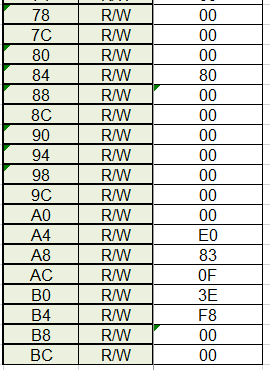

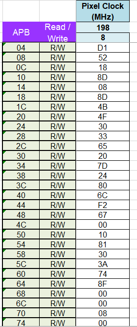

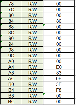

joanxie
couldn't guarantee that all of resolution can be supported by current bsp, but you can try it, try to add these parameters in the table to the samsung_phy_pll_cfg of phy-fsl-samsung-hdmi.c
