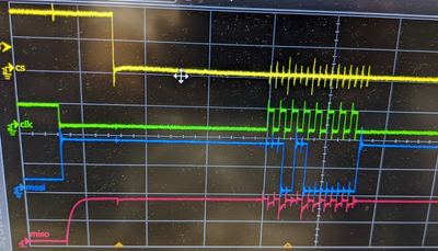

What i am seeing is that as soon as the address byte is sent out the SCLK is stopped, which makes the BME280 unable to send any data back.
What do i need to change in the device configuration so that the CLK is active as long as the CS is low?

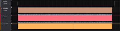

@arunlee did a test on 8mp, and I haven't found any problems so far. I tested it with spidev_test, this is the waveform of the test. The transmission of both modules is normal. The CS line is also normal. Please confirm that the connection between MISO and MOSI and the slave is correct. Also, can you test it with imx8mp ?
63,156 Views
kshitij_shah
@arunlee Attached is the waveform generated for imx8mp. Also looking at your waveform, the MISO does not have data on line. Or the MISO looks is set as Open Drain? The rising edge is so slow.

kshitij_shah
@arunlee Attached is the waveform. Also, the waveform provided by you, the data sent by the host's three wires (MOSI, SCK, CS) are all correct.

The signal looks the same that there is no clock persisting.
