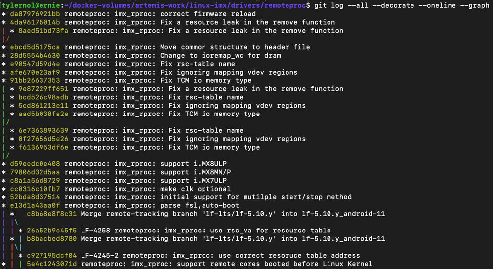

I also found this change to imx_rproc.c on linux master, but it is not on the latest android linux branch:android-11.0.0_2.4.0:
https://www.spinics.net/lists/linux-remoteproc/msg10209.html
doing some log comparisons of master /all to the 11.0.0_2.4.0 branch, you can see how far behind 11.0.0_2.4.0 appears to be:

is there an android branch that has been tagged and released yet that contains these fixes? In the meantime, I will try applying the patches to my local branch and test.
10,100 Views
tylernol
you also have tag
android-11.0.0_2.6.0, but imx_rproc.c is still at
| *   c8b68e8f8c31 Merge remote-tracking branch 'lf-lts/lf-5.10.y' into lf-5.10.y_android-11
