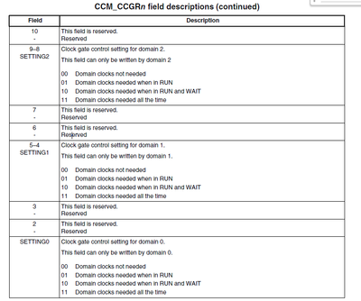

All UART, at least in our BSP, uses SYS_PLL1_80M
Best regards/Saludos,
Aldo.

you mean uart clock is hardwired with SYS_PLL1_80M, or configured.
if it's hardwired, Could you let me know how to check it with register ?
-Best Regards-
1,168 Views
AldoG
It is configured that way, even one could check the root clock on the CCM register, by reading the register 3038_44B0 (CCM_CCGR75).
Aldo.

u-boot=> md 0x303844b0 1
303844b0: 00000003 ....
u-boot=>
I can't catch the meaning of 0x00000003 for address 303844b0.
could you guide me how to find the clock of uart3 with this ?
-Best Regards-
Justin-Inno
1,072 Views
AldoG
Please do accept my apologize for the confusion it is a different register, it should be:
3038_A580 Target Register (CCM_TARGET_ROOT75)
Aldo.
