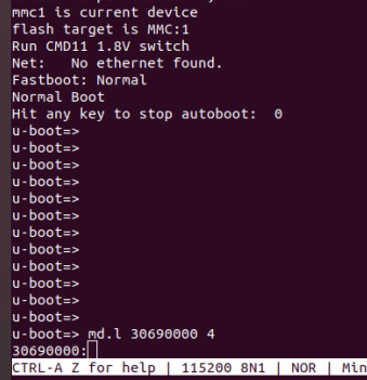

My lcd backlight need pwm control, so I config pwm4, backlight in dts:
lvds_backlight: lvds_backlight {
compatible = "pwm-backlight";
pwms = <&pwm4 0 100000 0>;
status = "okay";
enable-gpios = <&gpio4 26 GPIO_ACTIVE_HIGH>;
brightness-levels = < 0 1 2 3 4 5 6 7 8 9
&pwm4 {
#pwm-cells = <3>;
pinctrl-names = "default";
pinctrl-0 = <&pinctrl_pwm4>;
status = "okay";
I also open the driver: pwm-imx.c pwm-backlight.c in Config file
But it got stuck in the driver:
int pwm_config_internal(struct pwm_regs *pwm, unsigned long period_cycles,
unsigned long duty_cycles, unsigned long prescale)
u32 cr;
    printf("%s %d, &pwm->ir=0x%x\n", __func__, __LINE__, &pwm->ir);
writel(0, &pwm->ir);
    printf("%s %d\n", __func__, __LINE__);
cr = PWMCR_PRESCALER(prescale) |
PWMCR_DOZEEN | PWMCR_WAITEN |
PWMCR_DBGEN | PWMCR_CLKSRC_IPG_HIGH;
writel(cr, &pwm->cr);
/* set duty cycles */
writel(duty_cycles, &pwm->sar);
/* set period cycles */
writel(period_cycles, &pwm->pr);
return 0;
The log show the "&pwm->ir"  address is correct: 0x30690008, But it's stuck here :
It seems that the address 0x30690008 cannot be directly accessed
I have also tried using ioremap function to obtain addresses, But there is a compilation error prompt
I have also tried to disable the PWM4 configuration in DTS, and used:
  pwm_init(3, 0, 0);
  pwm_config(3, 5, 10);
  pwm_enable(3);
But we also encountered the same problem
Can someone help me please ?

5,476件の閲覧回数
Dhruvit
Hi @sclu,
I hope you are doing well.
Please confirm if you were able to read/write the memory from the Uboot command or not.
Kindly refer to the below files for the device tree configuration for PWM in the U-boot.
Kindly share the whole device tree file and the log you are getting in case of failure to further debug the issue.
Thanks & Regards,
Dhruvit Vasavada
5,436件の閲覧回数
sclu
Thank you for your reply, My driver is attached.
I use the md.l command, and the system hang up:

Dhruvit
Hi @sclu,
system hang-up is caused due to clock not being enabled for the PWM module.
PWM support for i.MX8M Processors is not available in the uboot version before v2022.04.
PWM  DM support & register support is added using the below commits in v2023.04.
arch: mach-imx: imx8m: add pwm_regs struct in imx-regs
arch: mach-imx: imx8m: add pwm ctrl registers fields defines
One can refer to the below-mentioned link to add pwm support in imx8m.
https://cuteparrot.pixnet.net/blog/post/229123814-%5Bnxp%5D%5Bimx8mm%5Dhow-to-enable-pwm1-on-uboot
Thanks & Regards,
Dhruvit Vasavada
5,390件の閲覧回数
sclu
Your answer perfectly solved all my problems,I add:
clock_enable(CCGR_PWM4,0);
clock_set_target_val(PWM4_CLK_ROOT, CLK_ROOT_ON |
CLK_ROOT_SOURCE_SEL(0)| CLK_ROOT_POST_DIV(CLK_ROOT_POST_DIV1));
clock_enable(CCGR_PWM4, 1);
Use my code and it will work!
