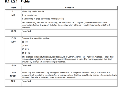

Q4. Section 5.4 Thermal Monitoring Unit (TMU) makes several references to TMR[ ], suggesting this is a register somewhere.. Can you please where I can locate a full definition of TMR ?
Specifically, I'd like the following ref manual references to TMR fields   TMR[ALPF],  TMR[CE],  TMR[MSITE].

For Q4, these references in i.MX8MM RM are not correct. These bits are in i.MX8MQ RM.
ALPF--> TMU_TER [ALPF]
ME-->MU_TER [EN]
MSITE-->ignore this bit in i.MX8MM. There are three monitor sites in i.MX8MQ TMU. But for i.MX8MM, there is only one site. You can find that with address offset.
