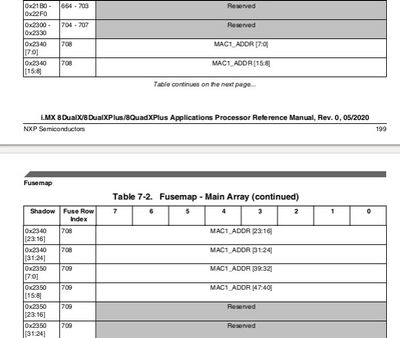

For Reference we were following this link "https://community.nxp.com/t5/i-MX-Processors/OCOTP-write-support-on-i-mx8m/m-p/825028"
+FB: ucmd fuse prog -y 0 708 0xa295fc11
 i can able to see they follow fuse row index.
 but in our case fuse row index is missing ?
 Can you please clarify on this one?

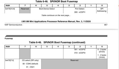

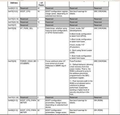

 1 ) We can able to see the 0x470[27] reserved bit is enabled. Can you please clarify on this one?
    2 ) We were trying to boot from ecspi2. what are the other things we should consider while eFUSE?
Vignesh.

Sanket_Parekh
Hello @vignesh-baskaran
I apologize for the delay.
->Please Use the link that is shared
https://www.nxp.com/products/processors-and-microcontrollers/arm-processors/i-mx-applications-proces...
https://www.nxp.com/docs/en/user-guide/IMX_LINUX_USERS_GUIDE.pdf
->I have also shared a few required configurations, Please take a look at it.
Please refer to this link for ucmd fuse prog
https://community.nxp.com/t5/i-MX-Processors/FUSE-burn-automation-on-iMX8QXP-UUU-FB-ucmd-fuse-prog/t...
1)We can able to see the 0x470[27] reserved bit is enabled. Can you please clarify this one?
->Yes,it is clearly mentioned that 0x470[27] bit of fusemap is reserved.
2)We were trying to boot from ecspi2. what are the other things we should consider while eFUSE?
->Please take a look at the OTP memory footprint which shows the shadow regs that need to be reserved there is also shared that Shadow regs should be used for boot-cfg purposes.
Thanks & Regards.

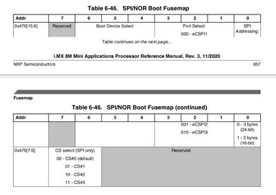

We trying to form the word for eFUSE,
We come up with,
0x470[7:0] -> 0000 0000
0x470[15:8] -> 0110 0010
so,
0x470[15:0] -> 0x6200
0x470[27:16] -> 0000 0000 0000
0x470[28] -> 1 -boot mode from fuses
0x470[31:29] -> 000
so,
0x470[31:16]-> 0x1000
so,
0x470[31:0] -> 0x1000 6200

 1) Can you confirm the chip select we choose is correct or not?
   2) if chip select is 0, then  0x470[31:0] -> 0x1000 6200 is correct?

Sanket_Parekh
I hope you are doing well.
I apologize for the delay in reply, please accept my apology.
1)Can you confirm the chip select we choose is correct or not?
->Yes, this chip selection you choose is correct.
->one can select cs select as per its usage for cs1 01 , cs2 10 & cs3 11 , So that is correct.
2)if chip select is 0, then  0x470[31:0] -> 0x1000 6200 is correct?
->Please refer to the screenshot I've shared.
->One can set the value, for example, cs0 then the value should be ox470[15:0] is 6 & if the rest are set to 0 which is reserved any way and make 28th bit 1 if the Boot mode configuration is taken from fuses & 29th bit if one wants a higher level of security should burn this. and rest 30 a7 31st bit are reserved.
->Please cross-check the value as per your need.
3)what is the use of CS select bit in 0x470? Can you let us know please?
->In the Serial peripheral device interface there is one master and more than one slave so, if the master wants to send the data to its slave then this chip select bit is used to identify which slave is should send the data.

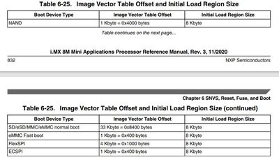

fuse prog 1 3 10006200
This command is correct.
->also already ported the SD image to ecspi2, but if we kept sw1101 as 00, we could not see ecspi2 booting also.
-Please make sure that IVT (image vector table) is different for both the SD card and ecspi, one can check the offset for the SD card or for the other in the RM.
-That is why it's not getting booted.

We consider the IVT (image vector table) for ECSPI.
$ dd if=imx-boot-imx8mm-lpddr4-evk-sd.bin-flash_evk of=/dev/mtd1 bs=1k seek=1
We used same image used for SD card boot.
We loaded this u-boot before writing value into eFUSE.
We were confused why its not booting.

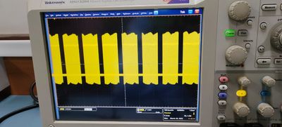

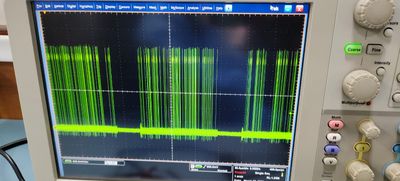

We connected CRO at clk while booting after eFUSE values written while keeping sw1101 as 00.
At CLK:
At MISO:
We were unable to see any output in console.
is offset => bs=1k seek=1 correct?
is There any other reason for this?
