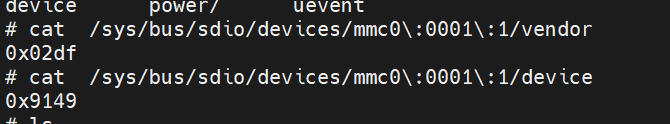

I use the latest official IMX8mm-EVK CPU2 version of the development board, using a separate compiled uboot kernel file system. When I adapted the WiFi (aw358) module, I found such a problem, and I hope it can help me solve it.
1. I have adapted the device tree correctly, because I can see the device node of sdio.

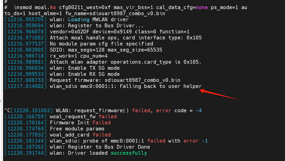

2. I will compile mlan.ko and moal.ko correctly. When I import the moal.ko driver to the kernel, insmod moal.ko cfg80211_wext=0xf max_vir_bss=1 cal_data_cfg=none ps_mode=1 auto_ds=1 host_mlme=1 fw_name=sdiouart8987_combo_v0.bin, now I get the following error:
 3、cann't find wifi driver

I took moral.ko and sdiouart8987_combo_v0.bin and sd8987_wlan.bin when it was the same path again, and I also tried to run the command: insmod moal.ko cfg80211_wext=0xf max_vir_bss=1 cal_data_cfg=none ps_mode=1 auto_ds=1 host_mlme=1 fw_ name=sd8987_wlan.bin Same, it can't import wifi drivers
