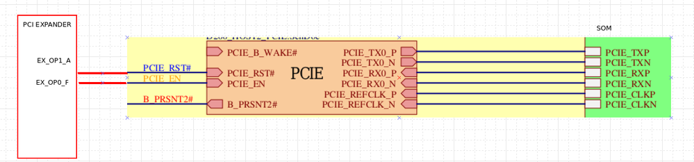

I have a custom board imx8mm. I am trying to enable the PCI1

My schematic is:  (is GPIO expander not pci expander  Sorry)
My dts file is:

igorpadykov
Hi Marius
for enabling PCIe on i.MX8M Mini one can look at NXP implementation in EVK, p.9
SCH-31407 schematic (seems it does not use PCIE_RST# signal)
 i.MX 8M Mini Evaluation Kit LPDDR4 Design Files
and sect.3.8. PCIE connectivity  i.MX 8M Mini Hardware Developer’s Guide
dts file :
https://source.codeaurora.org/external/imx/linux-imx/tree/arch/arm64/boot/dts/freescale/imx8mm-evk.d...

mariusoctavian
RESOLVED
The project I was working was using kernel 5.10.0-01182 as a base
and the implementation for internal clock for PCIe was missing.
Thanks to Igor we found that in 5.10-y branch; see above answers .
We merged (customer wanted to stick with 011.. kernel) the missing
code from imx6_pcie.c to our imx6_pcie.c.
We ran in
Failed to get PCIEPHY reset control
Later on we found that the 011.. kernel did not have the reset controller up to date
so we brought in few files from the /drivers/reset/* and some required headers from dt-binding
Viewing (22/30): 'drivers/reset/gpio-reset.c'
Viewing (23/30): 'drivers/reset/reset-dispmix.c'
Viewing (24/30): 'drivers/reset/reset-imx7.c'
Viewing (26/30): 'include/dt-bindings/reset/imx8mm-dispmix.h'
Viewing (27/30): 'include/dt-bindings/reset/imx8mn-dispmix.h'
Viewing (28/30): 'include/dt-bindings/reset/imx8mp-reset.h'
Viewing (29/30): 'include/dt-bindings/reset/imx8mq-reset.h'
Then we've also grabbed the Kconfig and makefile for the reset controller an enable it in the
kernel config.
Now I have the PCI up and working fine with internal clock config.

A suggestion where to look would be appreciated. I am wondering if LTSSM is used to test the link up in the imx8mm
because in the imx6_pcie_ltssm_enable() function for IMX8MM  all it does is a reset, and regmap_update_bits is used for other
models.
Thank you.

for "pcie: Phy link never came up" one can try several pcie cards.
igor
