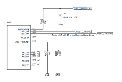

My custom board is unable to boot. Uboot starts but as soon as Normal Boot happens it errors out and keeps boot looping

I'm not sure what's going on. This custom board uses the same reference design as the 8MNANOD4-EVK

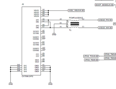

I've look at my schematic, USB1_VBUS is not directly connected to a 5V VBUS source, it would come from any usb device that provides 5V.

It seems there's a usb HW issue.

It sees the USB now but still errors out
11,658件の閲覧回数
igorpadykov
one can check usb power supplies: VDD_USB_3P3, VDD_USB_1P8, VDD_USB_0P8
and connections of USB1_TXRTUNE,USB1_VBUS using Table 8. USB recommendations
i.MX 8M Nano Hardware Developer’s Guide
igor
11,630件の閲覧回数
scvi
Reviewing our hardware schematics it is correct.
A little more detail. I'm using the latest LF5.10.35_2.0.0 linux kernel in the i.MX yocto project.
I'm only simply building core-image-minimal and flashing the eMMC using the uuu.exe tool in usb serial download mode.
After the fact I would switch it to usb boot mode.
I attached the serial output using a fresh yocto project building for imx8mn-ddr4-evk machine.
Also using the industrial version of the processor instead. Also the pre built binary L5.4.70-2.3.0 boots all the way to login prompt. Is there a difference preventing the latest release from not booting at all?
