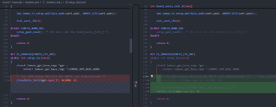

By this configuration I am expecting ENET_TD2 pad is muxed to be ref clk input.
I try to verify the pin config after boot the system up by reading pad registers value using mem tool. All looks right but the IOMUXC_GPR_GPR1 register content.
According to the chip reference manual, the GPR_ENET1_ TX_CLK_SEL bit of this register is '0' by default, but now it reads "0x00002000", which means the ENET_TD2 pad been set to output of ref clk instead of input as I desired.
I did not change any other source code. So I am not sure why IOMUXC_GPR_GPR1 value is not as expected. Is there any other thing may change the value of this reg?
Please hint me if I missed something.
thank you very much.
/Roland
591 Views
Zhiming_Liu
You need modify setting in Uboot/board/freescale/imx8mn_evk/imx8mn_evk.c
Best Regards
Zhiming
